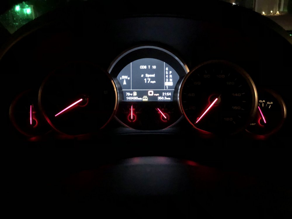

  9. I know its been a long time since anyones posted here, but does anyone know the part number, or where to find the part number, for the two transformers? I believe my illumination transformer is out and I figured if I'm there I might as well replace both. Thanks in advanced! Picture below shows what I'm talking about, the Digital display is fine along with the illumination of the needles, but the backlights are out.
  10. Thank you and I did stumble upon it when I was looking earlier for a solution. I've been driving my other car and couldn't get a picture of it till just now but here it is. It's not the digital display but the illumination on the gages. Sent from my iPhone using Tapatalk
