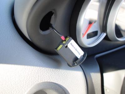

In addition I would also like to put the GPS sensor somewhere like where the alarm LED light is up front near the windscreen but again I cannot see any way to feed cables through so that they will go to the back of the head unit- albeit the cover comes off easily and I can see the sensor.

Cluster removal instructions are in the DIY section, somewhere. GPS is, from what I understand, installed by the factory exactly where you are thinking about putting it. I used the same spot to mount my XM receiver. Cover pops off fairly easily, be sure not to break it, ask me how I know ... There is a small hole there that you can feed a wire down behind the dash. Grab it from there and feed it whereever you need it. Might help if you yank the stereo for access.
