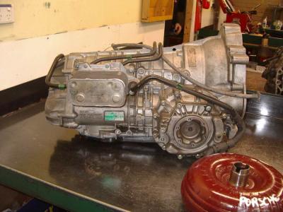

my mechanic is doing all the work but I just to know how much the whole thing cost and will the tip handel the 3.2 engine.
The tip is made by ZF. They use progressively larger/stronger tips denoted by increasing model numbers for handling increased power. The ZF tip desination for the 986 and 996 are the same. The same unit is also used in the early Audi TT, Passat and some Audi V8s. The Boxster S tip does use a "version two" of the same model number/design, possibly related to different gearing ratios to better handle the power.
