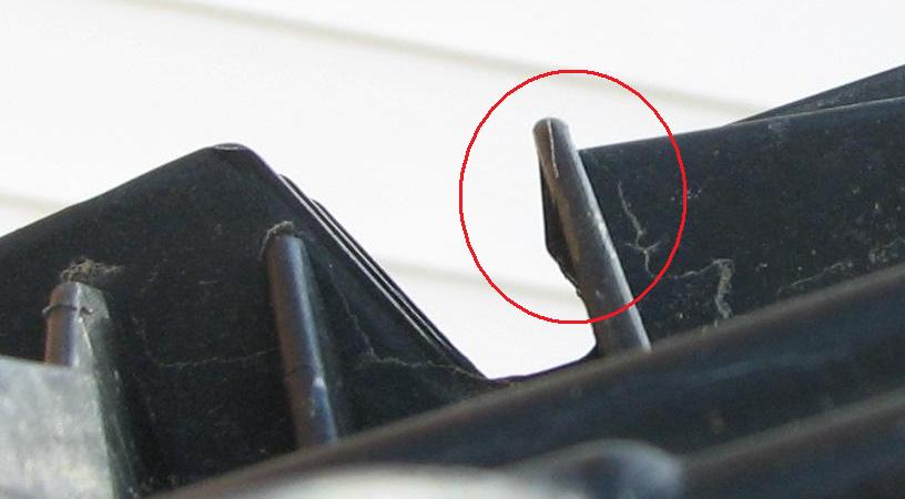

Here's a photo (below) of what makes that "pop" noise when turning the locking bracket during removal or installation.  The pop happens because the locking bar has to travel over the triangular peak in the "channel" of the headlamp assembly, circled in red in the photo.  That's the "cam" action mentioned by some writers.
post-21011-0-88968900-1415657635_thumb.j
