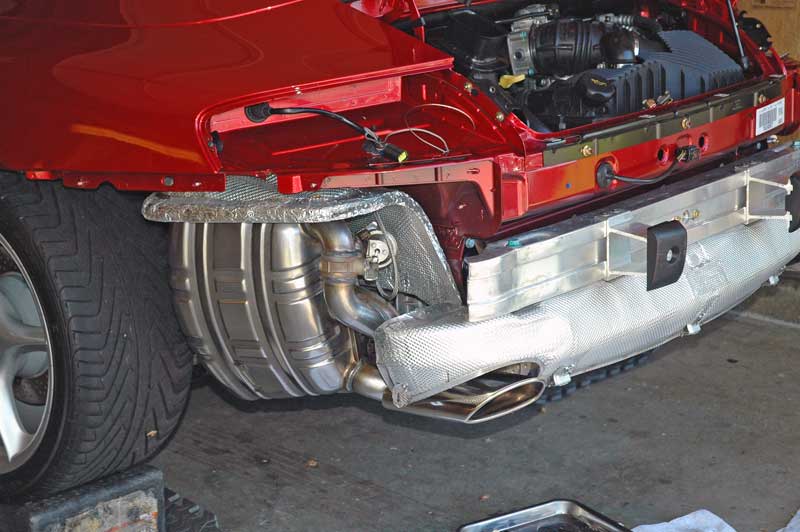

Here is a pic from one of our Moderators. The heat shield is the foil looking stuff around the muffler.
You do not need to remove the bumper or jack the car up. Just wait until it is cool or use protective gloves to isolate the rattle.
In a few cases there have been broken welds inside the muffler too.
(pic courtesy of Orient express)

To get to the shields, remove the bumper cover first.
The shields will the shiny metal parts under the cover. You will needs a 10mm socket and at least an extension or a series of extensions for the ratchet that can reach 16". There is a nut in the wheel well that is hard to reach without the extensions. The reast will be right in front of you, and all you got to do is check for loose ones.
No need to jack up the car, I do drive up some wood ramps to get me more clearance to work with , but not necessary.
