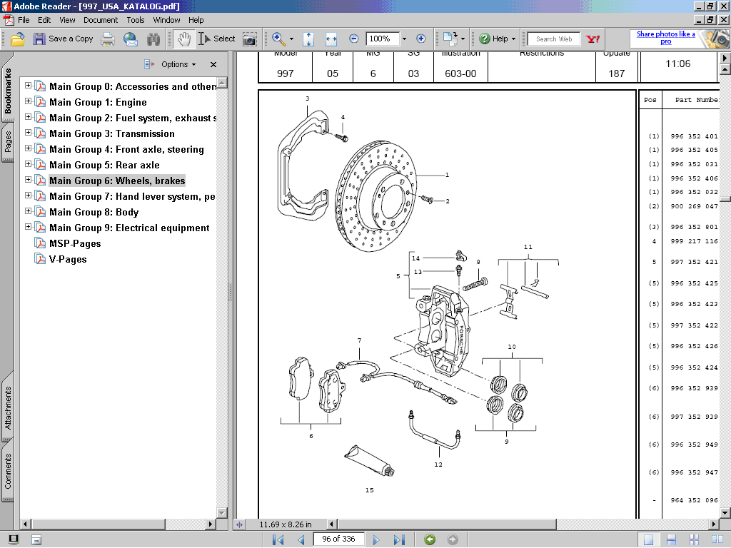

Hi,
I checked and the front brakes are just like the rears. The
sensors fit into the brakes. You would use a small screwdriver
and pry the sensor out. The only metal clip I see is the
one that holds the pads in. If you post a picture
I think we can all see the problem you are running
up against. The sensor wire is replaceable. I bought
racing brake pads and zipped the wires out of the way.
Paul
Hi,
I do not know how to paste a picture.
Enclosed is a file with the brake picture.
Paul
(edit - made image show in post - Loren)
