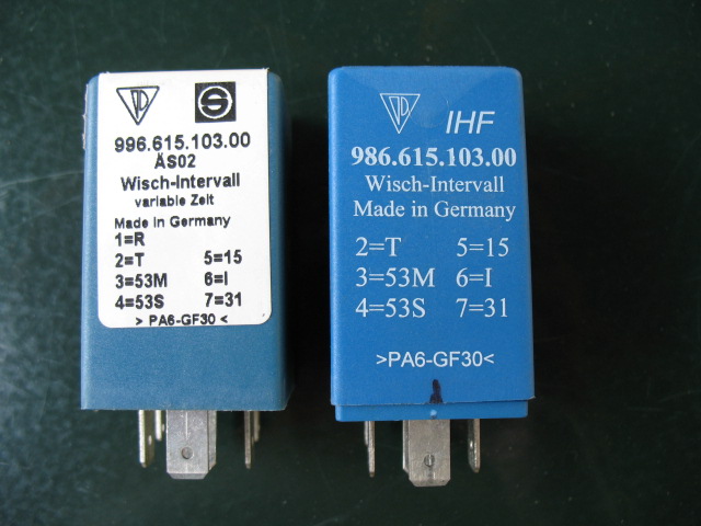

99% sure you have a bad relay since my Boxster did the same thing. Look under the dash above the fuse box. The wiper relay is the tallest relay. It is blue. It does not interchange with the other relays.
If you remove the relay you can still use the wipers. They will turn on and off with the stalk, but the intermittent and park features will not work with the relay removed.
In the picture the one on the left is a 996 relay, and the one on the right is a non S Boxster.

Absolutely spot on! Thanks very much. Just pulled the relay and it performs exactly as you say. Now off to buy a wiper relay.
