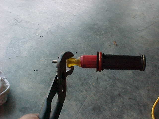

The rings can crack, and they cost pennies. I change the tubes and rings when I change plugs, Adds about $20 to the job, but it is "cheap insurance" to me. Specially after going thru the trouble of getting the plugs out, in my opinion.
Here is the expensive certified and patented extraction tool to remove the tubes when fingers don't work.
