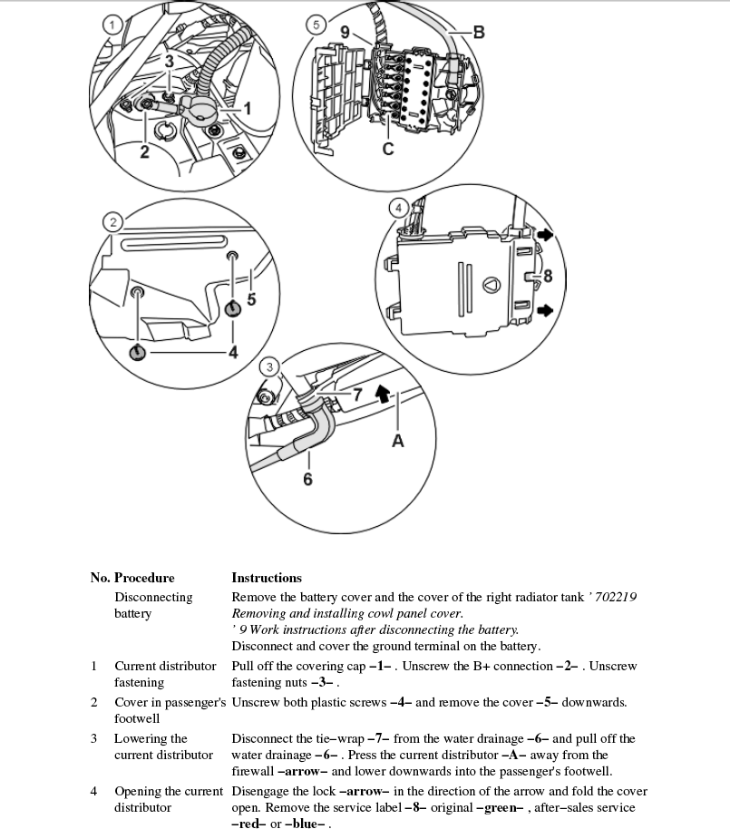

Item #13 is designated as the fuses going into this I imagine what I am looking for is the box between #15 & #8...
#16 is the item think I found it looks like quite the job to access it, Thanks for any confirmation of location of those fuses...

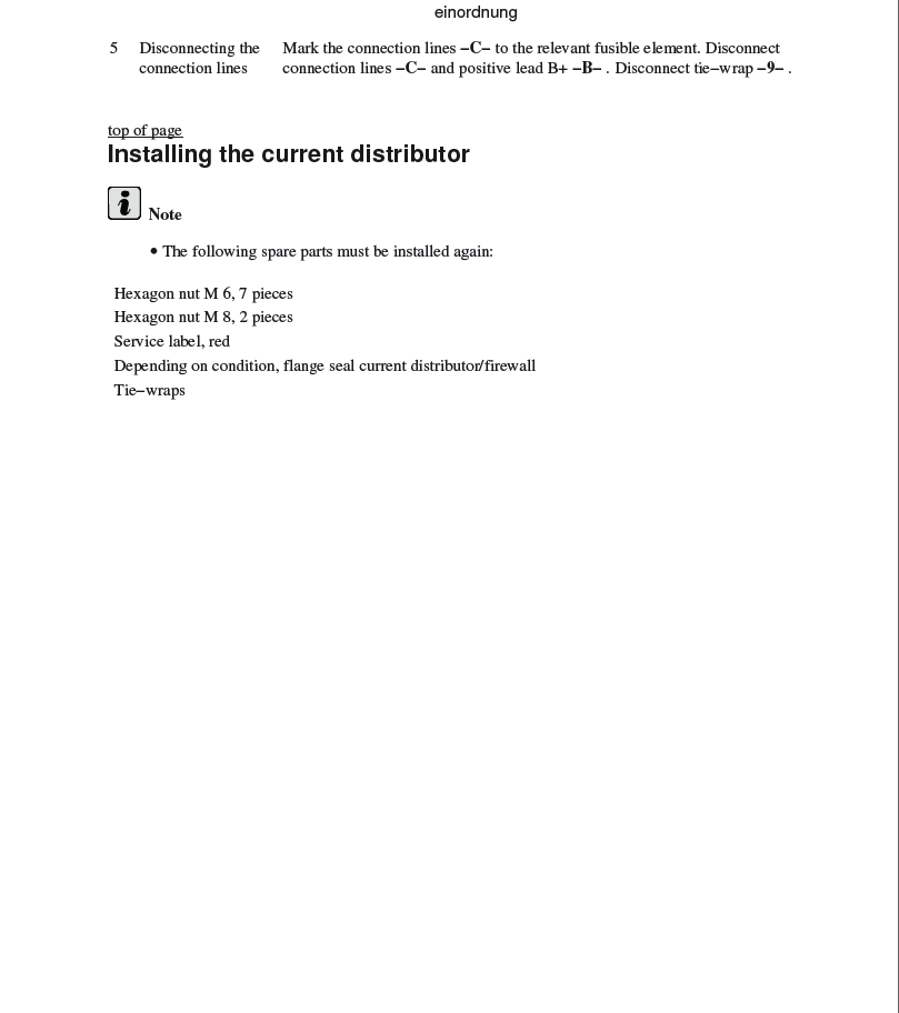

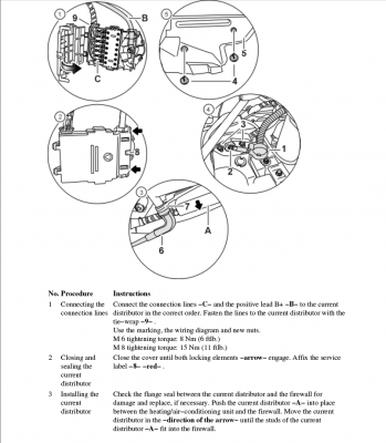

EDIT.....I have found the sequence for installation in the Tech Manual I purchased earlier today Pardon the post I do not know how to delete it.
