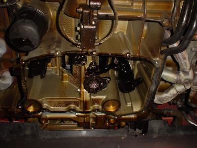

Thanks for the pic, Tool Pants! Somehow, I knew you'd have one ;) I will try to compare with a 996 pic I found. It's likely, but I'd rather not pull the thing apart just to find out.
But, the cylinder head scavenge pumps are at driver's side front and passenger's side rear, so in a weird twist of coincidence, any potential for oil starvation is the same with the 996 because the 3 and 4 diagonal cylinders (I think I got that right) swap positions.
