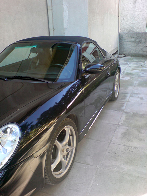

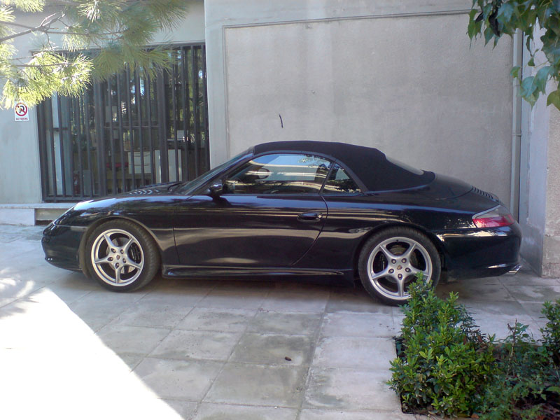

I got my kit from carnewal.com (excellent service btw!). Here are some pictures of the installed aero kit side skirts:
I tried to take a picture with the door open to show you the mistake I made but it is impossible to see with my phone camera.
