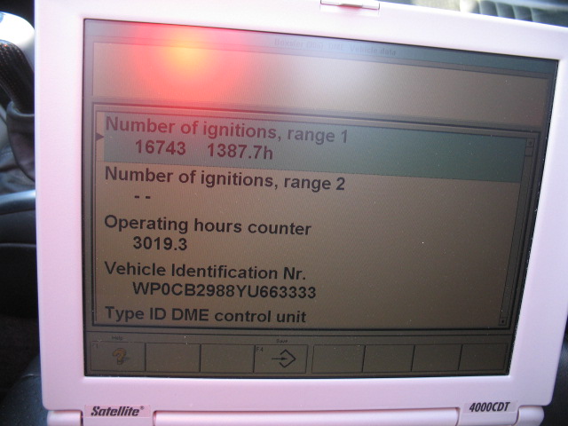

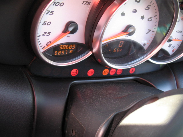

I tested the rule of thumb today on a 2000 Boxster S owned by Tariq.
The mileage is 98,689 miles. The engine operating hours 3,019.
If you do the math that comes out to an average of 33 miles per operating hour, not far off the rule of thumb.
Some time back Loren checked a 1999 996. 39,758 miles and 1,166 hours, or an average of 34.

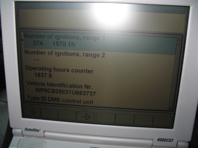

3 more examples. Neither were the original owners so they do not know the car history.
Joe with a 2001 Boxster 3.2. 49,391 miles and 1637 operating hours, or an average of 30. Looking through some info the car was originally from Southern California and is now in the SF Bay Area. Due to our traffic congestion this meets the rule of thumb test.
