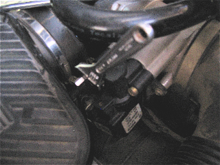

OK I got impatient started a job and of course needed a special tool, so heres the first on the list Porsche special tool P986hoho1
In case its not obvious the mini shifter wrench has a tork screwbit in the jaws making a right angle screw driver to fit in the tight space, taking out the 2nd screw on the ICV (you could add some blue tack in the jaws of the shifter, or spanner, so the bit doesnt drop out and get lost down below)
