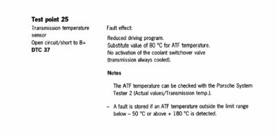

for the transmission, DTC 37 is Transmission Temperature Sensor (P0710 for OBDII). Here is what I could find about it:
Two things come to mind, the ATF coolant switchover valve or the wiring harness. The valve I replaced in my car, it was leaking. Easy job to do if you are so inclined. The valve could be stuck open. There is vaccum line to the valve, make sure it is not loose. The valve is plastic, under the car near the transmission cooler. If you clamp both coolant lines between the valve, easy to remove without a mess.
If the temp sensor is damaged, you have to replace the wiring harness as the "sensor is integrated in the harness". I would start with the valve, make sure the vac line (small black hose attached to the top of the valve housing) is secured, then replace the valve as it is pretty cheap relatitve to the harness.
