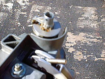

I need to change out my door lock to fit my new key and someone said it was easy by removing a spring and pin but for the life of me I can not see how it removes from the handle assy. Anyone venture a guess. :cursing:

Can you give us some better pics than that? <_<

I'll try but my camera is not the best. Do you know if it can be done?

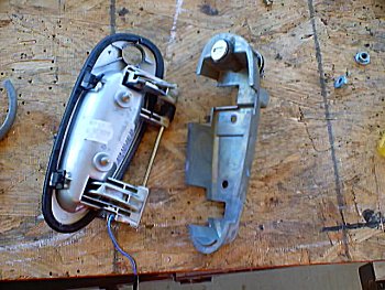

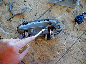

Lock with handle no problem but removing the lock FROM the door handle assy is a different story. <_< Found out how called porsche and they said to remove the 2 nuts holding the cast inner case with lock from the outer assy with handle. Man just to stupid to live!
