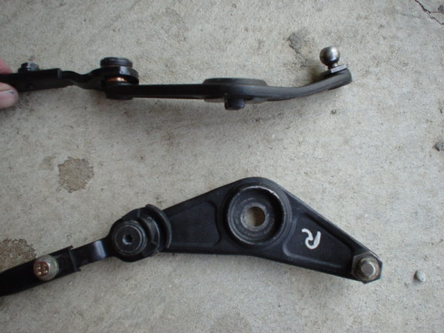

I tried to load the images I posted at the Kodak Gallery site and in the preview they worked just fine. Perhaps they are not accessible by linking in this manner to Renntech. When I just tried to put the URLs from there in the post, the preview bounced and indicated that the image formats were not acceptable.
I've tried it again by uploading the same pictures to Flickr.com. Let's see if they link:
The clamshell before I disconnected the pushrods.
The adjustment screw which was not even finger tight.
The left and right levers on my car.

ok, i see now.
replace the bent V-lever and replace the push-rods with the red end caps. those red end caps will eventually break. the new reinforced ones (from Porsche) are white. the metal ones at Paragon look fine and will be cheaper than buying the entire push-rods for both sides. when replacing them, just note how many threads are showing on the old ones, and make sure you have the same number of threads showing when you screw on the new ones. you might still need to do a little adjusting, but you will be very close.
to be honest, the V-lever doesn't look *too* bad. you might be able to bend it back. or just leave it.
i know you said that you replaced the cables before you had any problems (good idea), but i don't understand how the V-lever would get bent like that if the top was working normally. presumably it would take a lot of force to bend it.
that 'adjustment screw' doesn't really adjust anything, it just holds the clamshell to the screw that slides in the rail.

Due to the twisted/tweaked clamshell you have the typical top failure. One side of the top was moving, but not the other side. This is usually because one cable is being turned by the transmission and the other cable is not. The needed repairs have been covered several times already in the top section of this board. Your clamshell is not tweaked bady so get a friend and twist it back into shape - how to do this has already been covered.
Replace all bent or broken parts. Hard to tell for sure but the left V-lever does look bent.

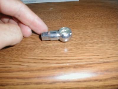

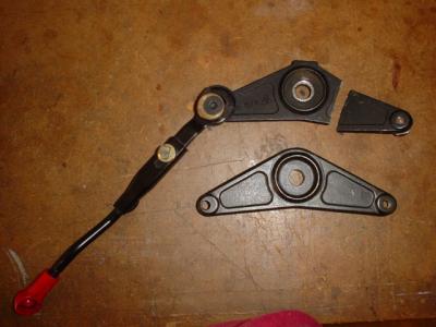

I assume you broke at least one red plastic joint. Scott Levy is the guy who came up with the metal joints sold by KLA - he is a 944 guy. Scott and I traded emails years ago when he wanted to know if there was a market for metal joints. And the use of oem plastic or metal joints has been debated here before. All that KLA sells is the joint. There is no pushrod or V-lever included like in the picture on their site.
Scott was of the opinion that the top can fail because the plastic joint get brittle from the heat and the plastic joint is the first part to break. My experience is that the joint breaks only after something else first fails. My clamshell was tweaked like yours but I did not break a joint - in fact I did not break or bend any other parts. Mine failed because 1 cable was not turning and I caught it quickly (I get out of the car to do the chop) so all I did was to tweak the clamshell.
You have any easy fix. If the V-lever is bent then replace it rather than playing around with it. If you have broken plastic red joints then get the white plastic joints from the dealer. It takes 5 seconds to twist your clamshell back into shape - you will still have the dimples but a dent guy can take them out.
This is the metal joint that is being sold.

From your comments, I'm guessing that the cable was the first to actually go and the bent lever happened as a result. The loose fasteners and lubrication may have allowed some binding that caused the cable to pull from the motor. I was really surprised at how loose so many fasteners were. I'll keep an eye on them in the future.
I have actually not broken either of the red joints, and they were on quite snugly, but I'll be chasing down a new lever and joint ends this week. With a little luck I'll be driving her again next weekend! (It rained all day today anyhow).

I do not know why your V-lever is bent. It could be from when you separated the joints for the black push rods for the clamshell. That joint can be under a lot of tension/pressure and I have see a broken V-lever that resulted from using a pry bar to separate the joint.

Okay, so I finally receive the metal rod ends from Paragon late Friday to finish the top repair and I am all excited to get the car back up and out this weekend. Unfortunately, the new rod ends are not threaded deeply enough to provide the same adjusted length as the original red plastic ones. Both joints (on both rods) stop about three threads short of the tape which I had put on the rods to assure adjustment like the original. The holes in the new rod ends are actually deeper than than the plastic part but the threads are not tapped nearly close enough to the bottom. I know I could cut off a quarter inch of rod and take care of it that way, but it bugs me to chop up a second piece to fix a problem with the first. So I'll start tomorrow to find someone with a metric bottoming tap to finish the job.
Has anyone else had this experience with the metal joint? I have emailed Paragon as it was the weekend and I supposed they wouldn't be there, but wanted the group to know of this potential problem. Also, there were no instructions with the joints as indicated at the Paragon site, but with the help here they are not too necessary. (Of course, it's a possibility that their instructions would tell me to cut off the rod I suppose)!

Screwing the joint in or out on the end of the threaded push rod is for small length adjustments.
You can adjust the length of the push rod itself. Loosen the bolt on the push rod and then you can make the push rod longer or shorter. Here are the KLA instructions. http://www.klaindustries.net/bxstr-end/kla_986topfix1.pdf You do not need to remove the clamshell as stated in the instructions, which they call the tonneau.
