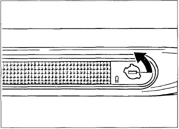

1. Using the tip of a screwdriver, carefully lever out the right-hand corner segment of the lens glass. Remove the corner segment from the lock.
2. Turn lock of additional brake light counter-clockwise by approx. 90 degrees and remove.

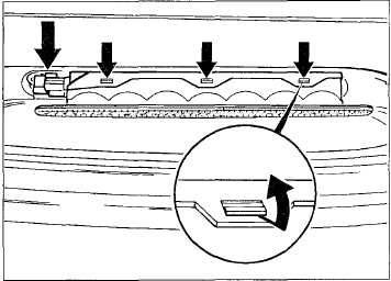

3. Disconnect electrical plug connection and disengage all fastening tabs of the bulb holder.
