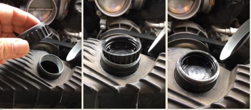

Yes. The air going back into the box is just muffled to reduce the sound. If you seal if off you will get a bit more sound at high RPMs.
Here is how I did mine using the cap from a quart of Castro Edge motor oil, which just happens to fit perfectly when inverted. Insert the cap upside down and reattach the hose. Done.
Edited by wyovino
Updated to add photos.
