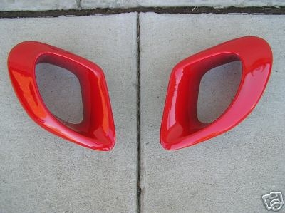

Im thinking of upgrading my side intake vents to 2003 series II, as below
on my 2000 Boxster, the vents are fixed to the car by tabs (on the louvres) which insert into three metal slots plus one screw. The the louvres on the 2003 vents are fixed it seems, so how are they actually attaching to the car?

Exactly the same way, based on how you are describing the 2000. I have a 2003 and the grills attach by 3 clips and a screw up through the top edge.
Other than some small lip they added to the front it's not much of an upgrade just a different way they were made.
If you want to paint the whole thing like on the 2003 cars you can just paint the intake you have no need to buy a new one to paint.
ok thanks thats what I wanted to know.
my grill or louvres were broken when I did the de snorkel mod so was thinking why not upgrade them to the 2003 look.
