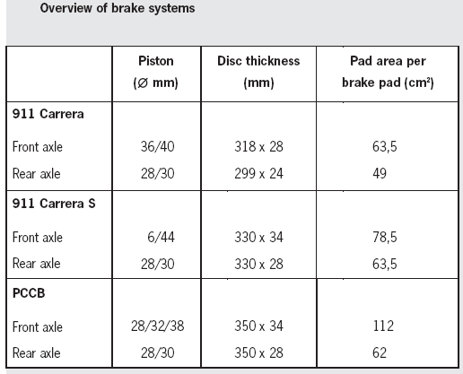

Here are the basic specs for the 997 series 911. PCCB are optional.

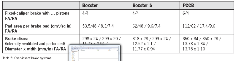

The Boxster and Cayman share the same brakes as do the Boxster S and Cayman S. PCCB is optional on all Boxsters and Caymans.
