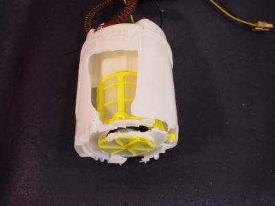

I took this picture at my local dealer 2 years ago. But I can not remember what happened.
That looks like it was run over! Anyway, being extremely skeptical that the fuel pump was the culprit, I asked to speak to the technician working on the car. The new (actual) story is that its not the fuel pump at all, but rather the fuel sending unit that mates the hoses to the tank. I've since seen the part which is indeed cracked and I have no doubt that when the tank is full it can leak from this point. I honestly dont know how this crack could have developed over a month's time, but apparently the technician who first worked on my car is no longer with the dealership so no one can provide answers.
