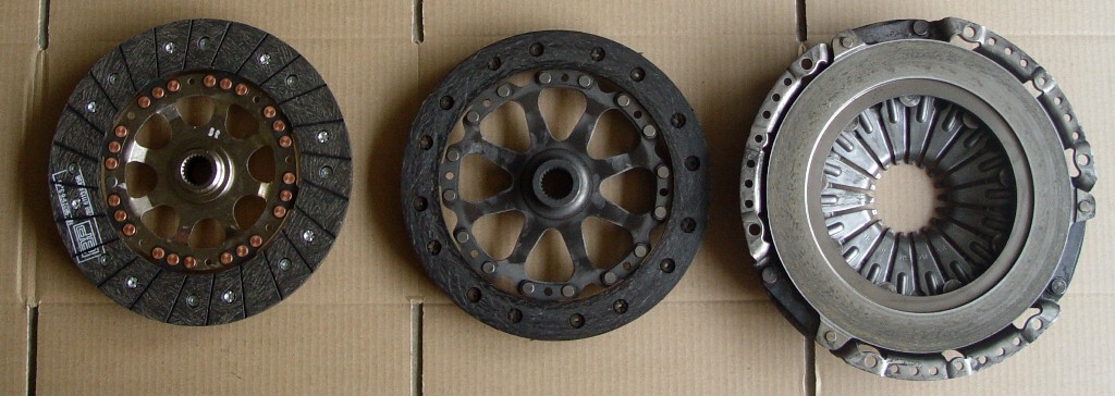

I ordered a new clutch disc and when it arrived I found that it was a different size than that already on the car. The following picture compares the new disc with the old disc and pressure plate.
The outside diameter was the same for both discs, but the inner diameter was smaller for the new disc. Although the new disc would have full contact on the flywheel, only the outer portion would be in contact with the old pressure plate. I’m guessing this is not an issue with the new pressure plate.

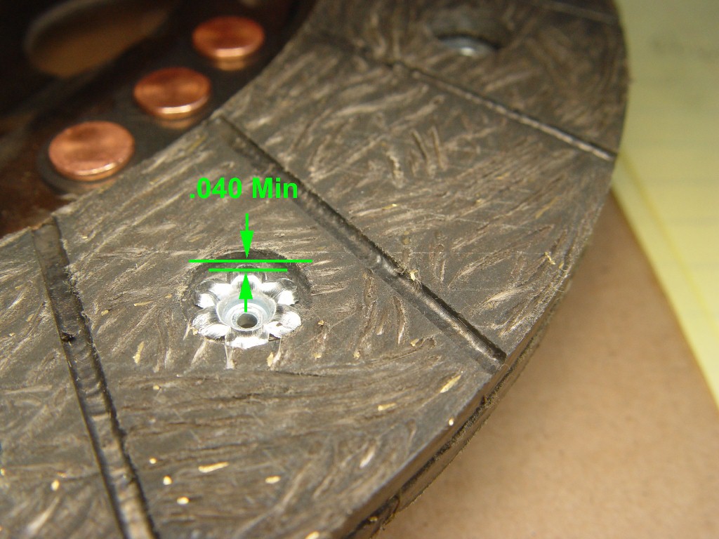

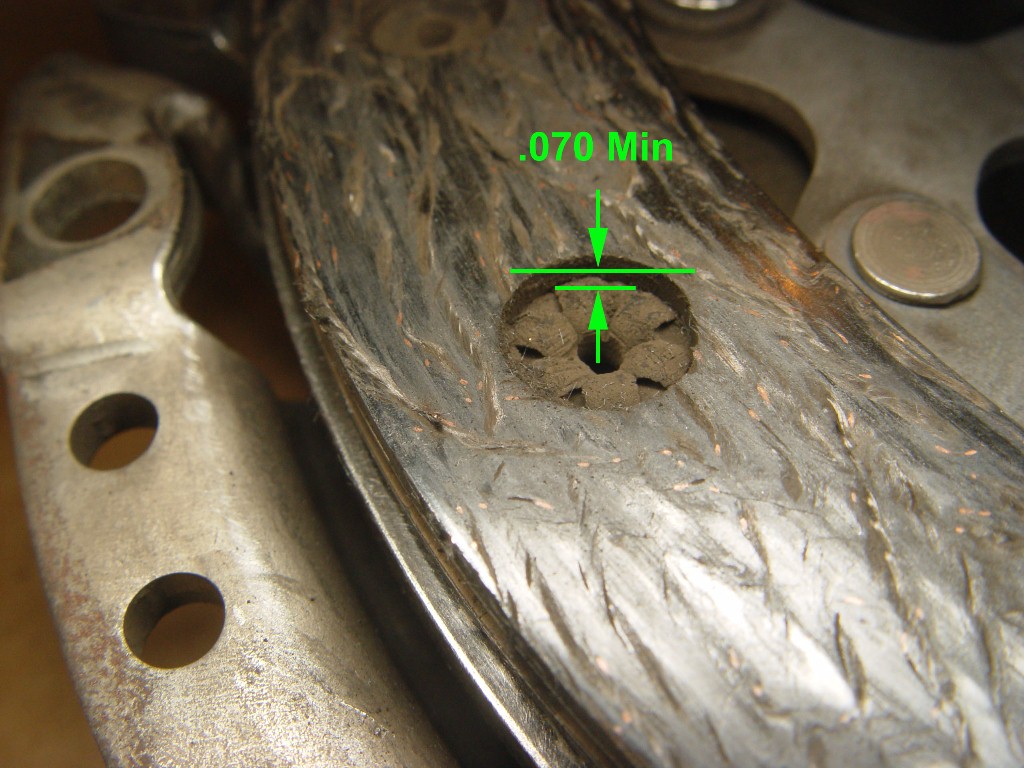

I also measured the thickness of the new and older discs and found them to be close in overall thickness. I then measured the depth from the face to the rivet and found that the old disc actually had thicker material on the face as shown in the pictures that follow. The depth to the rivet on the new disc ranged from .040 inches to .050 inches and the depth on the old disc measured .070 inches to .105 inches. As a result I put the old disc back in the car and returned the new disc to the parts dealer.
