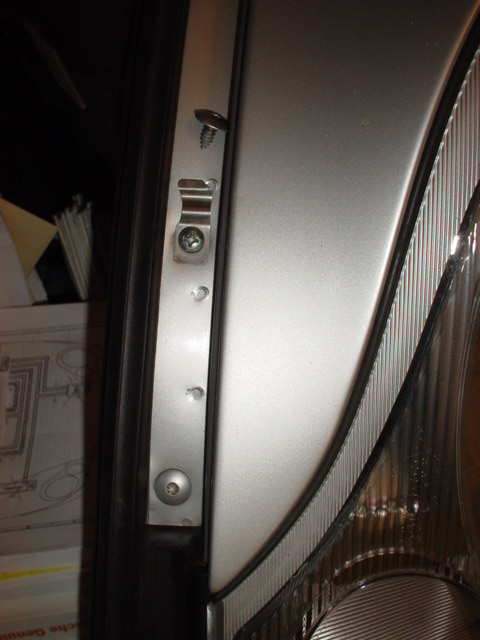

You need to remove 2 fender screws. These screws have a large head, with cutting "teeth" on the back of the head. A lubricant is not going to help remove the screws. The proper tool and brute force is the key if your screws are on tight. I use a ratchet wrench with a good quality torx bit. But then, sometimes the screws are not too tight.
Guess you were able to get the bra clips from Colgan.
Some very old pictures.
Thanks for the pics Jeff. Yeah, those screws are the ones I'm having trouble with. I did get the proper torx bit (came with the clips from Colgan), but also didn't use too much force. I'll check my toolbox to see if I have something that will attach to the torx bit and make it an easier job. If that doesn't work, guess I'll either take it in to a local shop or just wait for the next 'work on cars' day :). Thanks again.

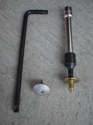

Watch out if you are using a crappy Torx tool if the screws are real tight.
The L-shaped one came with my bra, so I guess Colgan sent you the same thing. One screw was so tight I bent the L-shaped tool. Then I used a Torx bit (made in Taiwan) on my ratchet wrench and bent the bit. By that time I had chewed up the head of the screw.
To make a long story short my friend (owns a body shop) used a snap-on bit and got it out. The other side was not tight and I got it out with the L-shaped tool.
I then bought a set of Made in the USA Torx bits. If you want to stop by my office I can give it a try.
