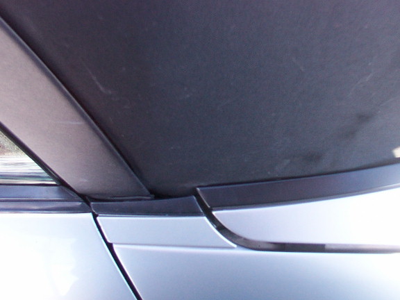

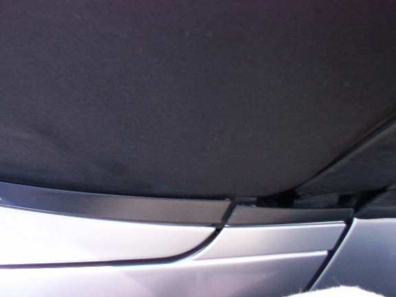

Hi I'm new to this forum. Tool Pants recommended it. I'm trying to fix my top by myself after the $2k estimate by the dealer. All the parts needed for fixing my top will be here this week (rods, transmossions,etc). All the parts cost me about $450. I will update this thread as I go along. But I have a couple questions: my Top Compartment/Cover is a little bit misaligned:

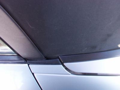

It should look like this:
I tried loosening up the cover and moving it to the left but that did little. The end of the cover is touching the top. I noticed that when I move the cover up and down, it moves correctly except when it almost reachs the down position, it moves to the right a bit.

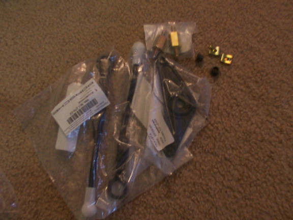

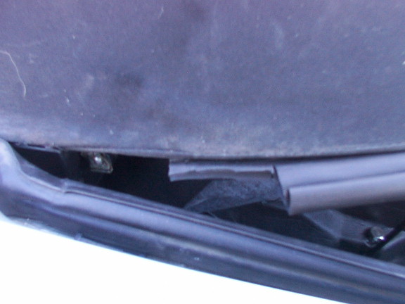

One more thing, is the gasket at the lower top look like this?
I ordered a new one anyway just in case:

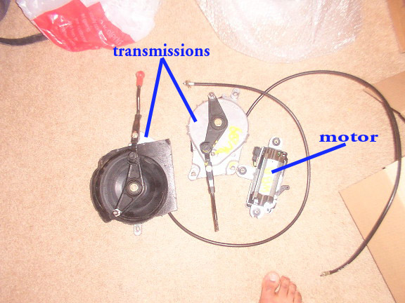

What is the history/story to date. I see what looks like old parts already out of the car - then a bag of new parts. All I know is that you bought a used 1997. The picture with the 2 transmissions and motor on the floor - are those the orignials which have been removed?
Have to wake up Mark for this one. :o
Actually the old looking parts are the "new" ones. They came off a 1998. They work fine according to the seller. One of my motors is broken, when I move the V-lever it is loose. It looks like the gears are stripped or something. I might as well replace both motors anyway but I'll see. I got a good deal on both transmissions and the motor ($250). I will start working on it tomorrow. I was looking at the motor today just to get a rough idea on how to remove it. I removed the plastic bolts, but it was still kind of stuck in there. Are there any other bolts?

Make sure that the black joint is snapped firmly in place, this might be causing your alignment issue. Also check the red joint.

There are 2 transmissions and 1 electric motor that operates the transmissions via cables. Other than the fact the clam shell is off-centered what is in your car now. Lift up the calm shell cover and show us some decent pictures.
Your "motor" is apparently a transmission. Do not understand a "loose V-lever." It might have just run off the gear. Why are you replacing the transmissions?

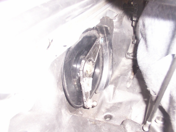

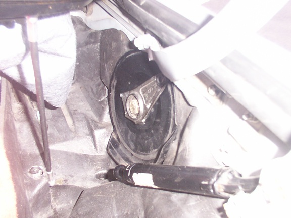

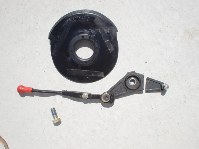

You have a problem child. I can tell you manually raise and lower your top from the last 2 pictures. Everything has been disconnected. You do not break the V lever unless someone has pried against it to pop off the ball joint for the black push rod that goes to the clamshell.

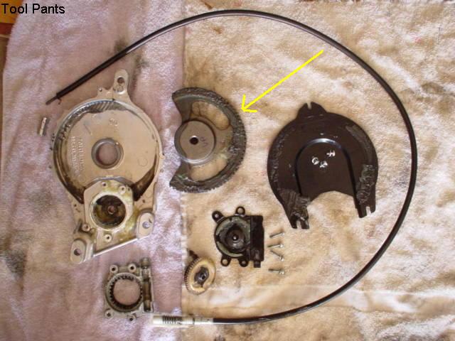

Do not know why you bought used 1998 transmissions or a top motor. They are the same for 1997-1999. What do you think is broken? Does the top electric motor work? You need to address the cables. What is wrong with your top transmissions?

After 6 hours of installing the newer transmissions and motor (from a 1998) and timing it, I finally got my to fixed! The timing was the hardest part. I don't know how to do it but my friend has mastered it, he can do it in less than 5 mins. BUt there is one problem (I'm not sure if it's even a promlem). When I put the top, every thing works perfect. But when I go up I hear some weird noises, sometimes 3 pops others are 2. I put the top in service position and observed the transmissions on their way down, after they reach the end they go further streching the strut. But then after about an inch of streching, the RV lever snaps back a tooth (on both sides one after another) then the mechanism stops.
I figure this can damage the teeth in the transmissions on the long run. Any ideas why this is happening? Is it not timed right?
I didn't inspect them but they look fine to me. When I put the top down, the transmissions strech the strutsand seal the top compartment properly. But when I put the top back up, the trans' try to pull the struts down to seal the compartment but then I hear this pop and the V-lever snapping back once or twice, sometimes three times before the cycle ends. We think that there are no enough teeth at the end of the cycle which can explain why it snaps back. How do I give it more teeth?
