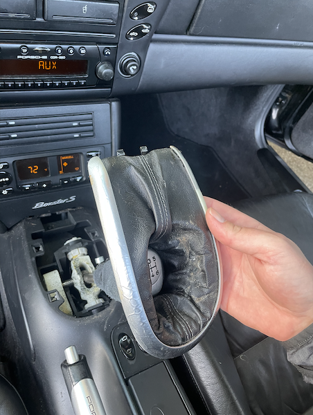

Sorry to revive a 13 year old thread but as this is the first google result for "986 Shifter Removal" I would like to add that the Sport Design Package shifter has a set screw. I nearly pulled a disk by following the "just pull" method. For the sport shifter, invert the boot and undo the set screw with a #5 allen key.
