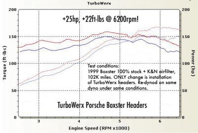

The 3rd set of headers I'm considering are by a company called TurboWerx,they are semi-new to the P-Car scene. They produced a Twin Turbo system for Boxsters. They claim +25hp w/ a K & N installed,and they have dyno charts to prove it. How they managed to get those types of gains I have no clue. You would think Gemballa , Fabspeed, evoms, or imagine Auto could come close to those types of gain but I have yet to see it.

Thanks bogg, I can attest to the louder nature of the SS exhaust, I have the Dansk unit and I'm very happy with it. I am contemplating headers, my only other experience with them is on a motorcycle. On the twin, they made the bike exceptionally loud, on the fours the effect was more muted. I'd like the Boxster to sound mean, however, with the top up, it's already quite loud in the cabin compared to stock, I wouldn't want it to gain too many more db's but i'd be fine with a throatier sound. Do you think it added any power? The claims are all about 25hp, that sounds lofty to me...
Expect 10. Expect nicer sound, not so much louder... Its much more... snarly...
