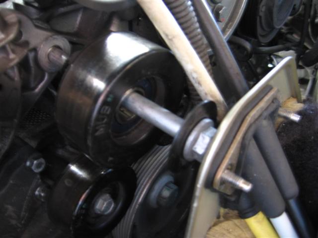

Robert Grindle on PPBB asked for help, thought I would ask for your help on this problem:
"Removing this bolt to replace roller or bearing. Cannot get it out far enough to remove without hitting the sheet metal. Any tricks or do I need to loosen the alternator? Looking through the archives I saw a post on replacing just the bearing and not the entire roller but no source. Doubt if the dealer has just the bearing. Thanks. "
His photo shows the problem quite well.
The Porsche manual only describes removing the alternator/generator along with this roller.
Has anyone found an alternative method to remove the long 145MM bolt?
A suggestion was offered: lift the engine 0.25" to clear the bolt -- what do you think of this idea?
"Removing this bolt to replace roller or bearing. Cannot get it out far enough ...
That manuals a dandy...
Ed
Why not? if the motor will go up that far...
