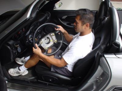

Alright Mr., do you have any instructions for us new, wussy folks so we don't cause major damage to our expensive babies?
I'm removing the Boxster 3 spoke steering wheel.
Then I'm removing the 911 4 spoke steering wheel.
And then the big swaparoo...followed by the tentative drive test. :)
Oh yeah, and I'll add x6 to your time, since I'm new at this.
Edited by gry
Don't know what step 21 is. You whould be able to do it with the renntech post. Do not let the air bag hang from the cable or you will break the plastic prongs on the spiral spring. If the cars don't have the OBC then it would be a good time to do the retrofit. The DVD has all of this on it.
