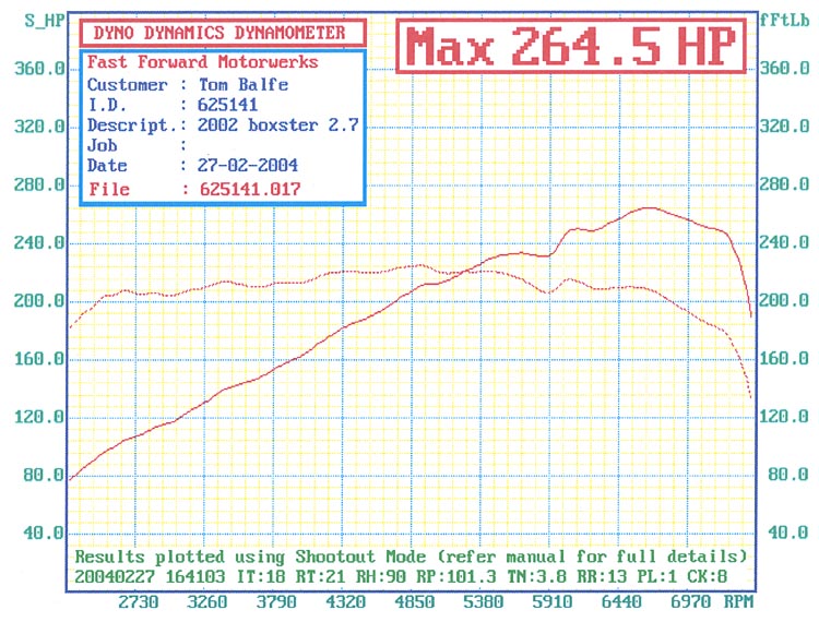

Cargraphic are good. I have the 200 cell versions of their cats and their headers. I'm told the 100 cell ones wear out and/or cause problems. I've never thrown a CEL with my 200 cell cats. Even though I have a Boxster and you have a 996, I think it's still a good recommendation, they make quality stuff. Along with the EVO intake and Powerchip, it helps me make 264.5 hp. I like Powerchip because you can send them your dyno pulls and they'll make the necessary changes to the spark and fuel maps. Oh yeah, mine is a 2002 Boxster 2.7, not bad for a car that's supposed to make 217 hp.
