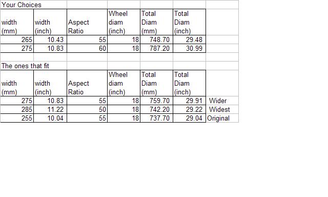

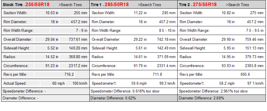

Hi, I did some research and apparently with the 18''s, 275/55-18 and 285/50-18 (cooler look) will fit, none of your original choices however seem to work. Please, note that the original size for these rims are 255/55/18. The table below will show u the comparisons I put together.
This is one of my sources for research: http://www.discounttiredirect.com/direct/a...&vid=008400
Hope this helps...

sorry I should have been more specific. All season and I wondering if 265/55/18 or 275/60/18 would work. Thanks for the reply

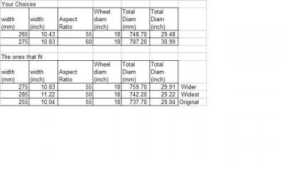

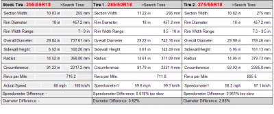

Hope this helps...
Found another important piece of info for you...Please, note the wheels size limits.

TireRack.com has pretty good information on standard OEM sizes.
A general rule of thumb is when changing tire size from OE, one should never exceed a 3% differential in tire diameter. I prefer to stay within 1% of the OE size. This is very important today because of all the electronic gizmos that are reading tire/wheel rotation data.
Check out my post above...It goes to the level of telling you how much 'gizmo's distortion' to expect from adding larger, wider tires.

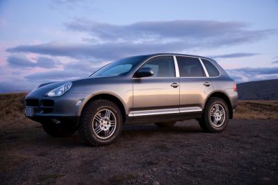

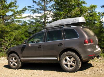

I just tried the BF Goodrich AT 265/65R18 (31.5") and had some rubbing in the front of the front wheel arches when turning. This came well before full turn as the edge of the BFG is very sharp. The tire shop didn't like this and I was a bit sceptical so we aborted the mission.
However I opened up the wheel arch covering and found nothing but air beneath, so I'm planning to bend the covering using a heat torch to get some more space. Hope to get this done tomorrow.

Made the tire change yesterday and drove carefully to my friends garage where we removed the front mud flap, bent the lowest part of the wheel arch cover over the lip of the bumper where the flap had been and then fastened with screws. At maximum height the tire would touch the mud flap so we decided to remove instead of operating on it.
Then we heated the arch cover and pushed it a bit in in the places that rubbed.
Now I have clearance of about 1.5cm when turning.
Very happy with the change, road noise has not increased and ride comfort is good. Haven't done any high speed turns yet and will do some rough trails over the weekend, so I'll know more soon. I'll try to take some pictures so those that are thinking about the change can see the stunning good looks of the Cayenne with the BF Goodrich tires!

Sorry for the late reply guys.
I snapped some pictures last weekend while fishing. In the second picture you can see the front wheel arch, where I removed the mud flap and bent the plastic from the wheel arch over where the mud flap was fastened. This is basically plastic to plastic with screws, but it holds pretty well. It doesn't look pretty up close, but you never notice it.
I had the BF Goodrich 265/65R18 tires microcut (as can be seen on the close up image) to be able to use them in the snow. Road noise has not increased noticeably. The car handles a bit differently, much better on gravel and only slightly worse on asphalt.
I recommend the change to those that want to use the Cayenne off-road or on rough roads.
Thor

Very cool. Thanks for posting the pics. It looks great. What an awesome off-road vehicle.
Share this post
Thanks, I bought it to take it off road and that's what I'm doing.
The only issue I have left is the air intake which is lower than I'd like, but I doubt I'll buy a snorkel for it ;)

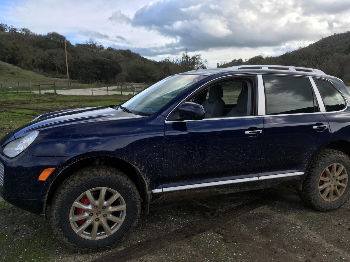

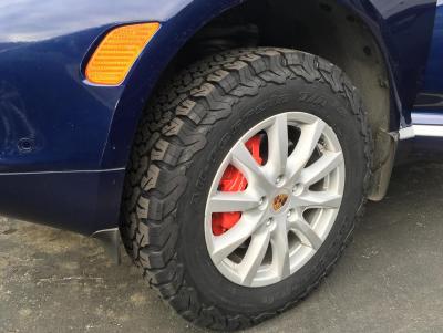

I used this thread as my guide for some new wheels and tires for my 2004 CTT. Previous owner had installed some 22" rims with low profile tires that were pretty rough around town and not quite my style.
I went for some BFGoodrich TA KO2 tires, per this thread size 265/65-18, and bought some 18" rims from a newer Cayenne. The installer I brought it all to thought I was crazy and was sure they would rub, but a few hours later they called back completely surprised by the good news - no rubbing even with the factory wheel liners and mud/splash guards. I did later make it rub (only on the passenger side) at the lowest ride height setting with the wheel at full lock and suspension at extension turning around a ramp in a parking garage, but it's very minor and rarely am I in anything but normal ride height.
I did some off-roading in the Hollister ORV park with the tires, everything worked out great through all the green trails and both obstacle courses. Lots of curious glances and comments there and since then. There's nowhere near as much road noise or groove following with these KO2s as I've experienced with my old truck and similar aggressively cut off-road tires.
I definitely recommend the change if you're interested in taking the Cayenne off road or are going for a completely different look that fills out the wheel wells more.
