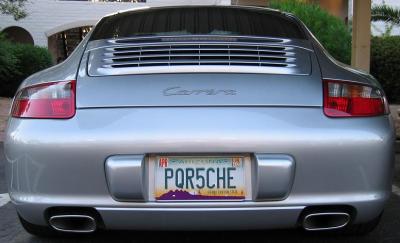

I Currently live in Ohio, and will move to Holland next summer. I have a '06 997C2 which i will import as well. I informed about the alarm, and the insurance companies require a class 5 alarm (GPS tracking). What i did is changed the side indicator lenses for clear ones, and changed the setting in the computer so they will blink now with direction. Can the daylight running light setting be changed in the car's computer as well? i was also wondering if the units that they placed next to the rear license plate can be removed, so a standard NL plate will fit? (p.s. What is the PWIS unit?) Thanks!

In regards to the rear bumper; the 2 lumps sticking out can be removed, but you are left with 2 holes, which I believe are bigger then the Dutch license plate will cover. An OEM European bumper cover (without the 2 lumps) is not too expensive, but they come unpainted.
If you are going to swap the rear bumper cover (I am), I would wait until after visiting the RDW (Dutch ~DMV), as I believe that if you have your car inspected with the US rear bumper cover, you will get a notification on your registration (kenteken) that will allow you to use the smaller sized (US style) license plates, so that you will have the choice between Dutch or US style.
