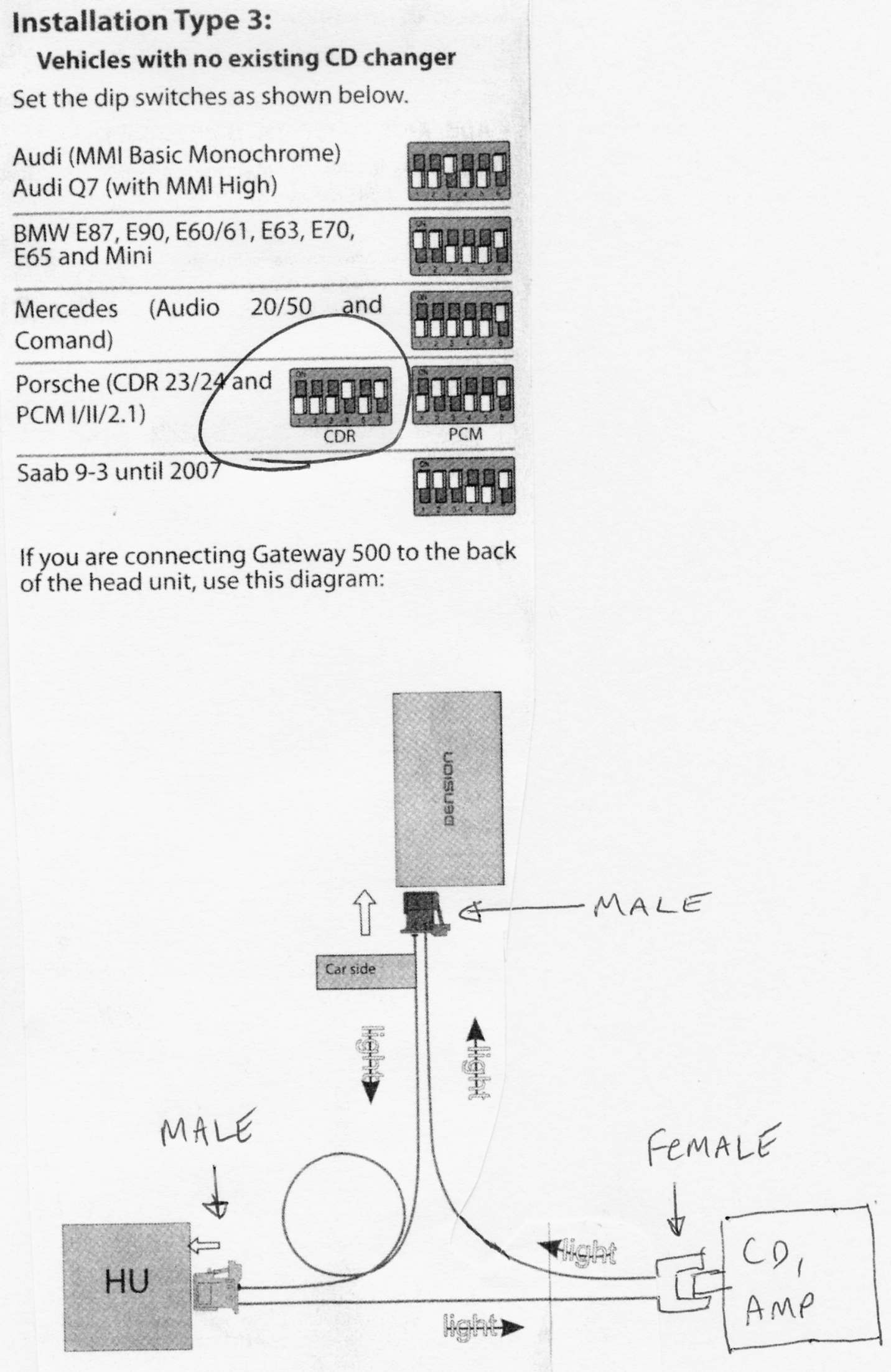

After much testing with the various configurations in the manual, I chose Installation Type 3.
I dismantled the FO cables from the connectors and created my own loop per the diagram. I then had to make sure I had at least one female connector in the loop and two males. I connected the one female connector to the connector coming from I’m guessing the Amp/CD changer (this was the connector that was originally connected to the head unit). I then connected the other two male connectors (one to the Car Side of the Gateway 500 and the other to the head unit). I then had to disable the CD changer by unplugging the power and creating a loop in the FO ring at the CD changer. I did this by dismantling the FO connector and using the FO barrel connector that was provided in the installation kit to essentially splice the In/Out FO cable together.

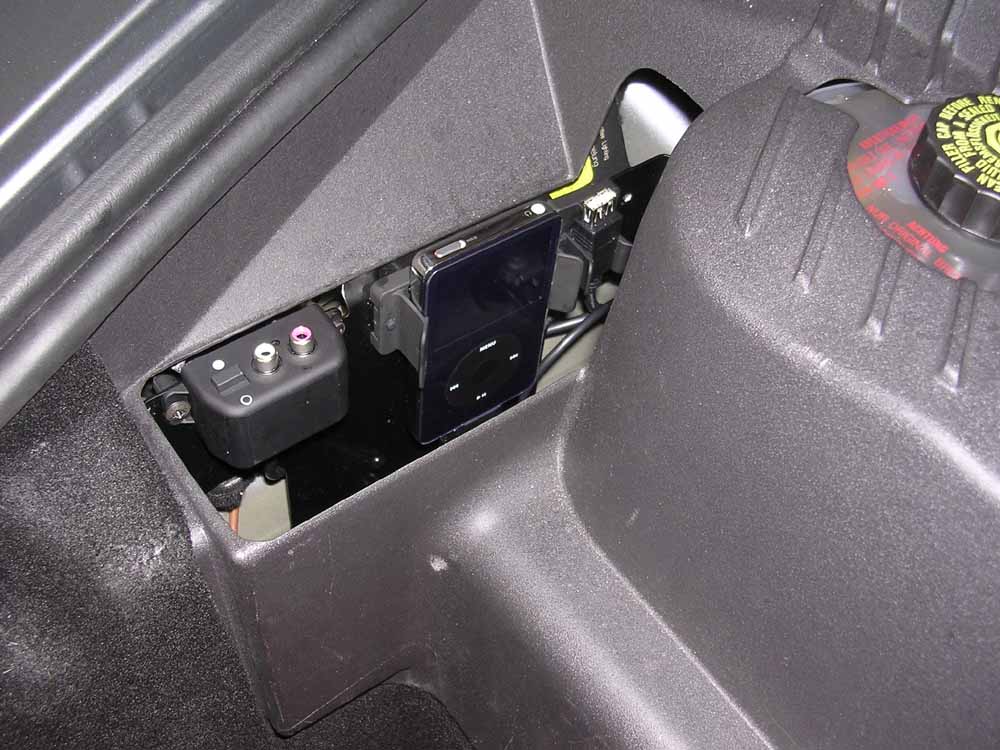

I just fitted mine with PCM2 and I have to say I am really pleased with the results. I knew the CDC would be redundant after the install so I took mine out and used the bracket that holds the CDC. I now have my USB,RCA and Ipod connectors poking through where the CDC used to be. I have a C4S Cab so didn't want my Ipod vunerable in the cabin. I have mounted the gateway 500 on top of the petrol tank under the trim. I never had to touch any of the dash apart from turning on the screen.

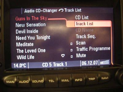

The screen text is better than I expected with only one gripe - the play lists, artists or albums are displayed in banks of 30 on "pages" which means the page needs "turning" when scrolling though.
The number of tracks in tracklist is limited. Imagine, if getting 30 song names from iPod takes about 2-3 secs, and users typically have some hundred artists and some thousands of songs. If you don't use paging it would be very slow.
Anyway, there's an option to increase or decrease the size of the pages. (It needs a special config file to be placed onto a USB stick).
