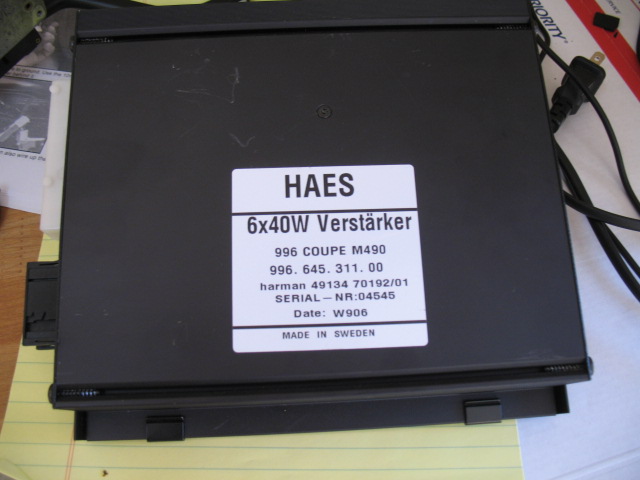

Ask the seller to give you the info off the white sticker on the amp.
Info provided...
HAES
6X40W Verstarker
996 Coupe M490
996.645.311.00
harmen 49134 70192/01
Serial - Nr which is the serial number
date: W949
made in sweden
uhm old school HAES. I don't think there is any fiber optics for that one. I got like 5 of em floating around my shop(very crappy)).

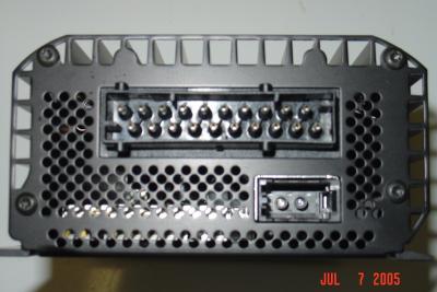

996.645.311.00 is not a current part number.
For 996 (coupe only--targa and cabrio may differ) with M490, the part numbers in PET (update 203, about a year old now) are:
996.345.301.01 through 2000 model year
996.345.321.00 for 2001 and 2002 model years
996.645.331.01 for 2003-on
996.645.331.02 for 2003-on (supersedes 996.645.331.01)
996.645.331.03 for 2003-on (supersedes 996.645.331.02)
The last three, 996.645.331.xx, are MOST and are the same amps used in Boxster with M490 for 2003-2004. The connections for these amps should look something like this (sorry, one pic is a little blurry):
The optical connection is the one on the bottom.

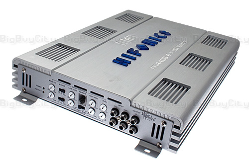

This is what I'm using HIFONICS TXI440(mentioned in new sound sys upgrade topic) - 55W x 4(4OHM) 110W X 4(2OHM) RMS though
if U were to rate this Like how Haes guys do, who knows 500W x 4? This is going to push my single POLK 8"DVC in 2OHM then 2-4" dash(CLIF DESIGN),2-5-1/4"mids door,2 tweets rear pocket(CLIF DESIGN), 2-3,1/2"(INFINITY) rear - all running in series(maybe stabled in 1 OHM?)

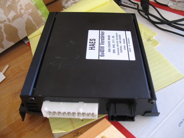

I think that 996 645 311 00 amp from a 996 will work in your 2001 Boxster.
http://www.renntech.org/forums/index.php?s...=9187&st=40
In fact, one of the local guys with a 2000 just bought that amp to power his rear speakers. I took a picture of it at our work on cars day, but I don't know if he has put it in yet.
It is from a coupe, not a cab. I asked one of the mechanics what was the difference between a coupe and cab amp, and he thought it might be the crossovers. I don't even know what crossovers are.

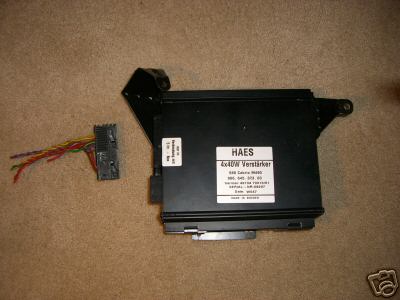

I just bought a 996 amp from ebay for my 1997 to power rear speakers. I don't have it yet. Part number 996 645 313 00. Seller said it is from a 1999 C2 cab.
Pictures are of the amp the local guy bought.
Well I don't know what to make of this amp or the seller for that matter. He claims it is from a Mercedes 996. :unsure:
