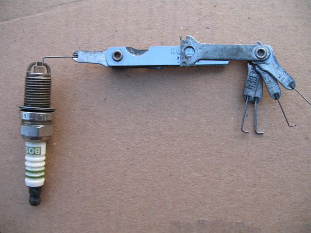

14 FR 7 LDU has 2 side electrodes. The gap is 0.8mm, plus or minus 0.1mm. This plug is used on the 1997-1999 2.5 liter Boxster. I did not think a 2 side electrode factory plug was used on the 996. This plug you can gap. but you should use the type of gauge in the picture.

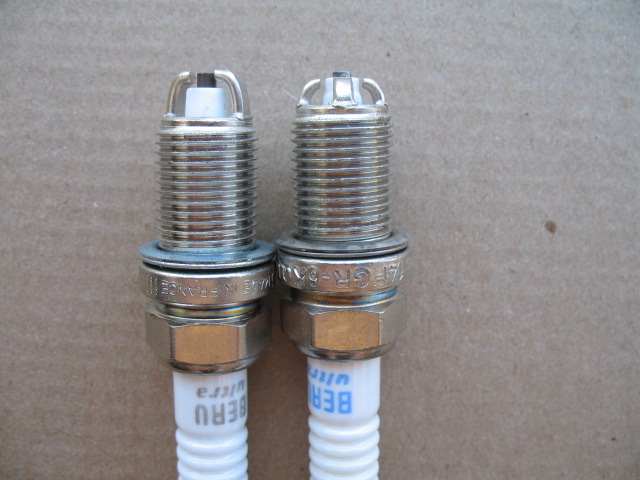

14 FRG 6 KQU has 4 side electrodes. I know this plug because it is used in 2000-2004 Boxsters. The gap is 1.6mm. I have no clue how you would measure the gap on this style plug. The mechanics at the local dealership don't gap them. They are good to use out of the box unless they have been dropped on the ground.
In the second picture you can see the difference between the two style plugs, and that is why the gap specs are different.
