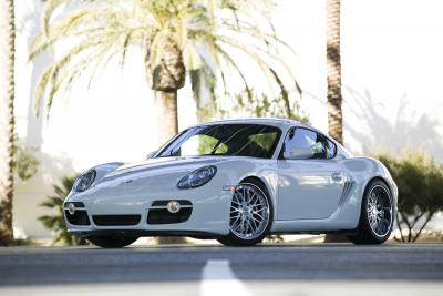

I'm running 19x8.5 frt w/48mm offset and 19x10.5 rear w/ 38mmoffset. Tires are 245/35 and 285/35

Thanks for the info! What wheels, brand/name, are you running? They are beautiful! Is your car lowered? PASM?

Wheels are Vellano(www.vellanowheels.com) Style is VSA - 3 piece forged centers and barrels.Machined finish with clear coay. 2' lip frt & 4" rear.Susp is KW Var 3 coilovers. non-pasm
