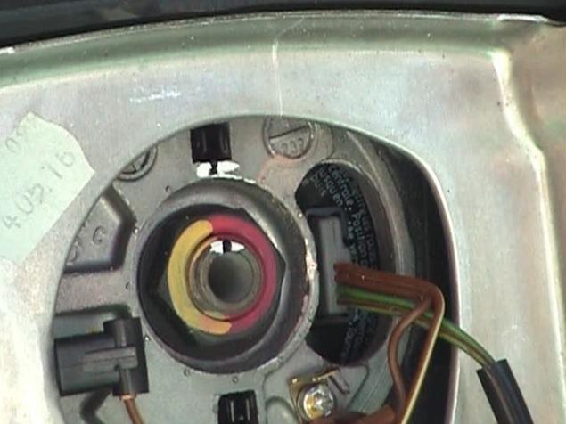

Look at the black alignment marks I made. On your replacement wheel the center of the square hole should be aligned with the black mark on the shaft.
Do not break the plastic prongs that stick out from the air bag spiral spring when you push the new wheel on the splined shaft.

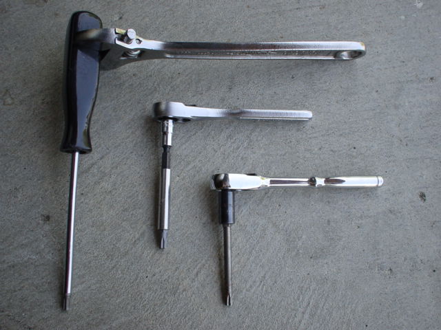

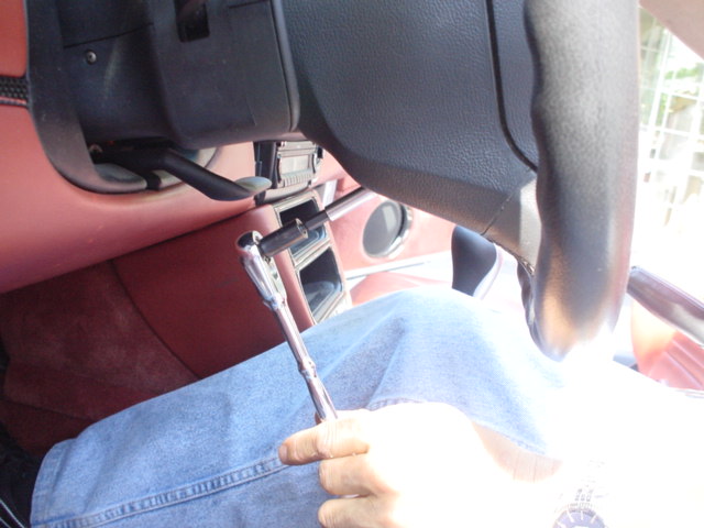

If your T30 tool is in the head of the torque screw then you just need to turn it counter clockwise. If you are using the screwdriver type then it is hard to do because you have little leverage and may have to use pliers on the handle. There is loctite on the screws so it takes some effor to break them free. The screws are on an angle so your tool should be on an angle.
I use a torx bit on the end of a ratchet wrench.

1) the airbag bolts were impossible for me to remove with the T30 with the standard handle ... ToolPants's rachet idea was a requirement, not an option.
2) A Torx T30 bit the required length (about 2.5" long) was very difficult to find
3) An extension adaptor for a shorter TA30 Bit would not fit in the whole (of my 99' four spoke) to remove the screws

Very good. Those little air bag screws are only 7.5 foot pounds but with blue thread lock you need Popeye arms unless you have the proper tool.
If you use a short T30 bit in a magnetic holder the holder is too "fat" to fit in the hole on a 4 spoke but does fit the larger 3 spoke hole. So I bought a 2 3/4" long bit to use on my 1/4" drive ratchet since I was removing so many steering wheels.

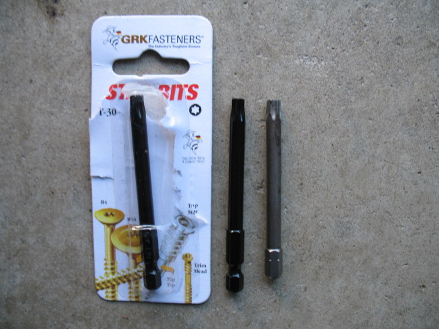

I was at a local hardware store, looking at tools, and found 3" long T30 bits. It was an ACE hardware store but not all ACE stores stock the same stuff. They are now using them for screws. Two bits for $5.79. They are made in Taiwan, but they will work. http://www.grkfasteners.com This is the first time I have seen T30 bits longer than 2" at a local hardware store.
My old 2 3/4" T30 is made by Hazet. I had to get it on the internet. It is now about $9 for that one bit.

I found a 36 Piece Extended Driver Bit Set with T 10 thru T40 for $16.99 at Griot's Garage. Each bit is 3 inches long.
