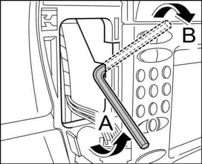

I wish I could remember for you, but it was several years ago. Mine came out quite easily without any tools...I have an 04. Found this:
Removing display and operator control unit (PCM 2)
Note
If the PCM is replaced by a new or a different PCM, read out the data with the Porsche System Tester
before removal. => Teaching display and operator control unit (PCM 2)
Switch ignition off and remove ignition key.
1. Unclip switch cover from below using a plastic spatula and disconnect electrical plug
connections.
2. Insert a hexagon−socket wrench sideways into the screw connection of the PCM detent
hooks.
3. Close the detents (2 each side) with the hexagon−socket wrench −A− and carefully pull out the PCM.
4. For re−installation, open the detents with the hexagon−socket
wrench −B− .
