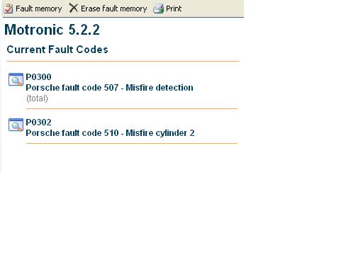

I just replaced the spark plugs and now I am getting a missfire on cylinder 2:
First of all, is cyl 2 the middle one on the passenger side? The middle cyl on the driver's side is OK, but I did notice that the wire for the one on the passenger side does not 'click' when I reconnect it to the coil. The wire cover (the boot) is a little lose and I can't seem to be able to get rid of this missfire error. Any ideas?

EDIT: I was able to snap the connection back in and the missfire error didn't come back (so far). I let the car running for about 10 minutes. I would still like to know how to change the wires though, if anyone knows :)

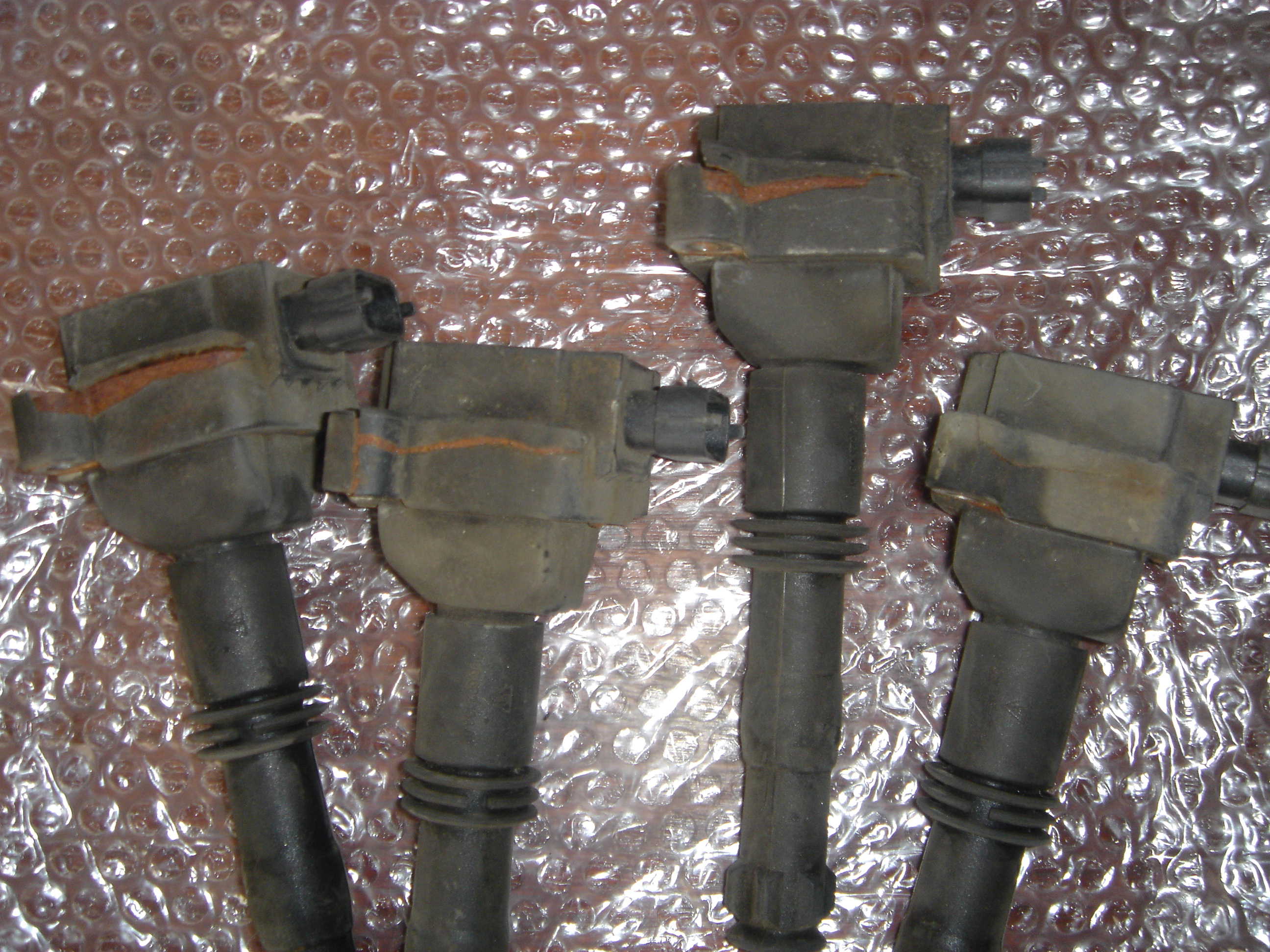

Cracked coils are not an uncommon complaint. More common complaint on the UK message boards for some reason - guess it is the damp weather. If you need to replace then replace just what you need.
The coils are made by Beru. You can find them from parts places other than Porsche.
Pics from Tim on boxa.net
You're right. The car runs fine. I guess there is no need to replace the wires since the coils are separate entities.
Wow, those coils in the picture are really bad! Mine just have a small crack, very little. I'll see how much they cost and take it from there.
