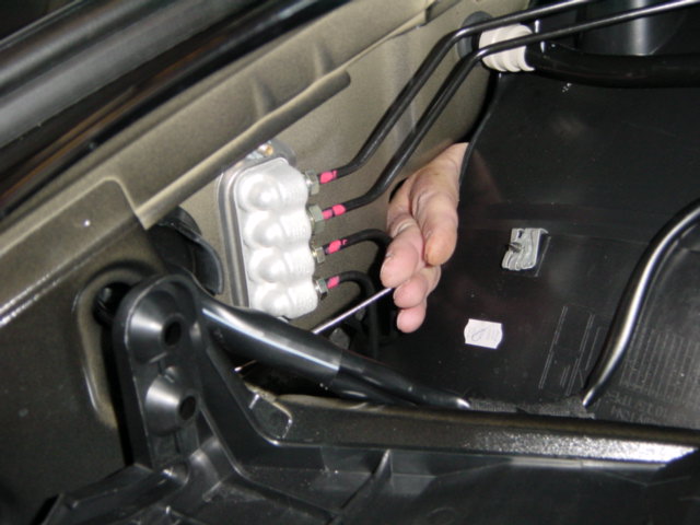

It does. My hand is on it. Headlight removed for the picture. But it is on the left side. On this car it did not have a loop on the end of the cable. Take out the left headlight so you will know where it is.
I have been told by 2 mechanics that the jumper in the fuse box will work even with the battery removed.

Thanks Tool Pants
I just spent about an hour trying to get behind the fender panel to find the release on the right side, as it was in the Boxster. So they switched sides to make it more difficult for us. This is great info, thanks a load.
DANNOV
When the 987 came out the dealership had a tech session. The headlights were out of the car. I searched the right side of the car and could not find the cable - thought Porsche did away with it.
When the Cayman came out there was another tech session. Headlights out of the car. This time I searched the left side and found it.
