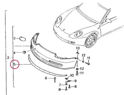

my dad pulled out of the garage at a not so optimal angle and scraped up the lower lip pretty bad, then he told me later on the freeway it broke off and he ran over it -_____-
do they sell just the Lower Spoiler part of it? where can i find it? i'm thinking about buying a couple and painting them flat black in the meantime so i can help him drive the car better.
Item 5
996.505.986.00 spoiler lip -- MSRP $76.34

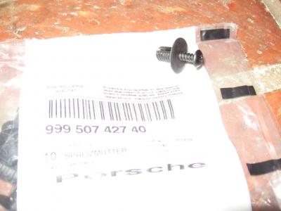

You may also need the attaching plastic rivets 999.507.427.40 (11 required) -- MSRP $0.21 each
Item 5
this is great news! are the plastic rivets bolt on? or do they require a special tool to install the lip?

As I recall the rivets are just push on - similar (if not the same as the wheel well liners).

The rivets are two piece with a plastic expansion plug along with a plastic screw. The plastis screw has a phillips head. I keep spares since I have torn mine off once or twice. The plastic screws will spare any damage to the bumper. If you are lucky enough not to run over the lip, you can just re-install if you have sares. As Loren said, they are really cheap. You may want spares for such occasions. :D
