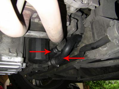

One runs from the overflow tank down to the bottom rear driver's side of the motor. Apparently this one tends to go out often as it runs right by the headers, and the heat takes it's toll. It had been replaced before on my car. The other three seemed to be original and had the original spring-loaded hose clamps. The two that run to the front of the car were bonded to the little plastic retainer brackets. I guess that will happen after almost 10 years and 94,000 miles. I was able to get the rear two hoses off by sliding a flathead up inside the rim, but I had to cut those front hoses off. They just weren't going to budge.
I had a slight bit of trouble getting the short, bent hose on the passenger rear to seal where it goes into the motor. I kept getting a little drip on the motor side. There's not much space between the flare on the metal spout and the back-end of the spout, so it turned out the hose clamp I had put on there was too fat and not seating behind the flare. I dug around in the toolbox and found a skinnier clamp that just barely fit. As you can see in the pictures, there's no extra hose sticking out on that fixture.
I did it all with the rear wheels up on ramps. I refilled it in this position with the vent valve open and left it over night. In the morning I had to add more coolant. No trouble with air in the lines. In fact, just by changing out that 2 gallons or so of coolant that drained when I pulled those hoses, the car is now running about 5 degrees cooler. That's making me think I should go ahead and flush the entire system soon.
