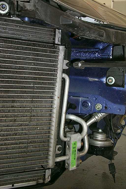

you disconnect the AC radiators. These are held in place by two torx screws on the inboard. . .
. . . and by a slot on the outboard. After removing the two inboard screws, carefully slide the radiator inboard. Be careful with the aluminum tubing, which is connected to some hefty rubber hoses. Make sure the rubber bends, not the aluminum!
