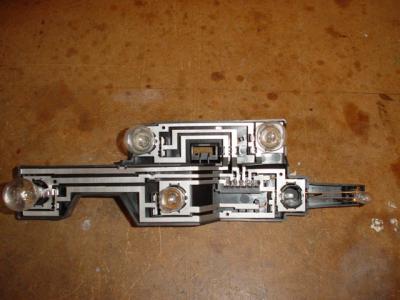

Need to see a picture of the bulb holder. Like this.
Tool Pants , it looks just like your picture except it has tha amber bulb for the cleat turn signal lense. Are there different part numbers for the bulb holders for the clear tail light from the orginal amber tail lights? I checked all the fuses and they all seem to be fine.

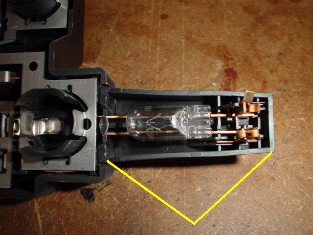

This picture is the extension piece a ROW bulb holder does not have. The bulb for the running light is the type you can remove by pulling straight out. The bulb laying on the side in the picture is the running light bulb.
This is why I asked you about the bulb holder. To see if the prior owner bought the ROW version that came with the ROW bulb holder. You must have the US version because you said there is a little bulb at the end, but is it the little bulb laying down that you can remove by pulling it out?
This is why I asked you about the bulb holder. To see if the prior owner bought the ROW version that came with the ROW bulb holder. You must have the ROW version because you said there is a little bulb at the end, but is it the little bulb laying down that you can remove by pulling it out?
Tool pants , thanks again!! the right rear bulb holder looks just like the one in your picture, it has the bulb at the end that you can pull out and the extensions you were talking about. I went and replaced both bulb holders for the left and right side, the left works perfectly all lights work, its just the right side that the running lights dont work. Any other suggestions.
