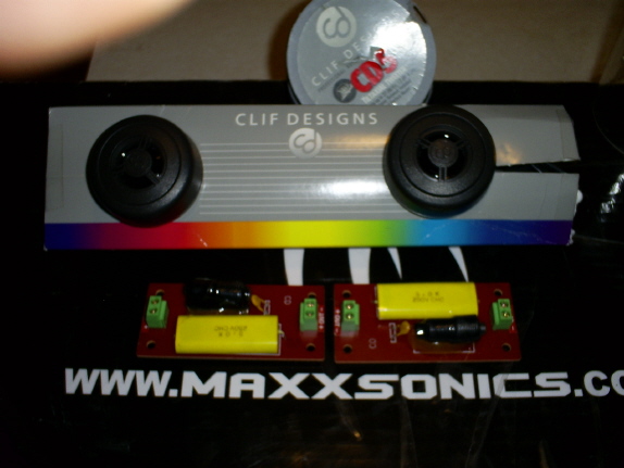

I've no problem with adapting the front dash grill to fit the new 4" speaker and 1" tweeter but i've never done the crossover bit! Please could someone explain how to wire from the speakers to the crossover and then to the om amp.
Any pictures woud be great.

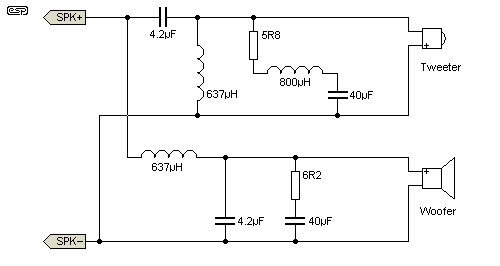

Possibly, are all of the speakers in the same locations for both coupe and cabriolet? And are they of the same size? There could be different crossovers employed to compliment the speakers used.
Essentially a crossover is designed to pass the appropriate frequencies to the speakers that are best designed to handle them.
An example would be this; the woofer by design is large and designed to move lots of air, a tweeter is small and has a light fast reacting cone to radiate high frequencies. So sending hi frequency sound to a sub would or low bass to a tweeter would be inefectual, as each are designed to reproduce a specific range of frequencies, in fact connecting the tweeter to the "bass/low" termnal on a crossover would likely damage it.
This is just the basics, and there is a lot more to then just this...
