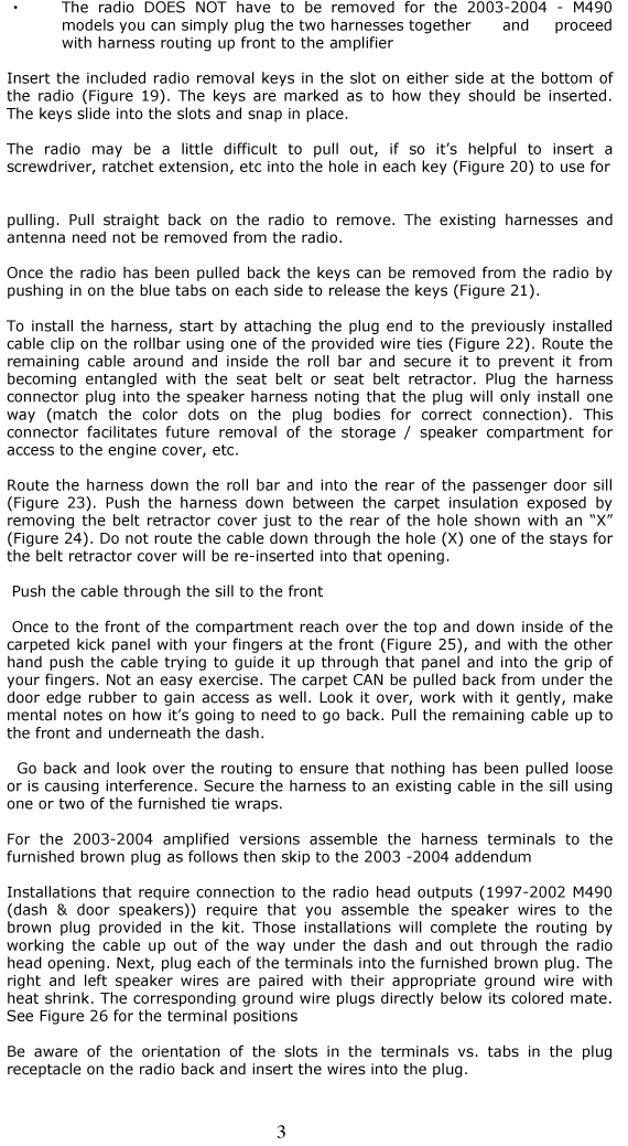

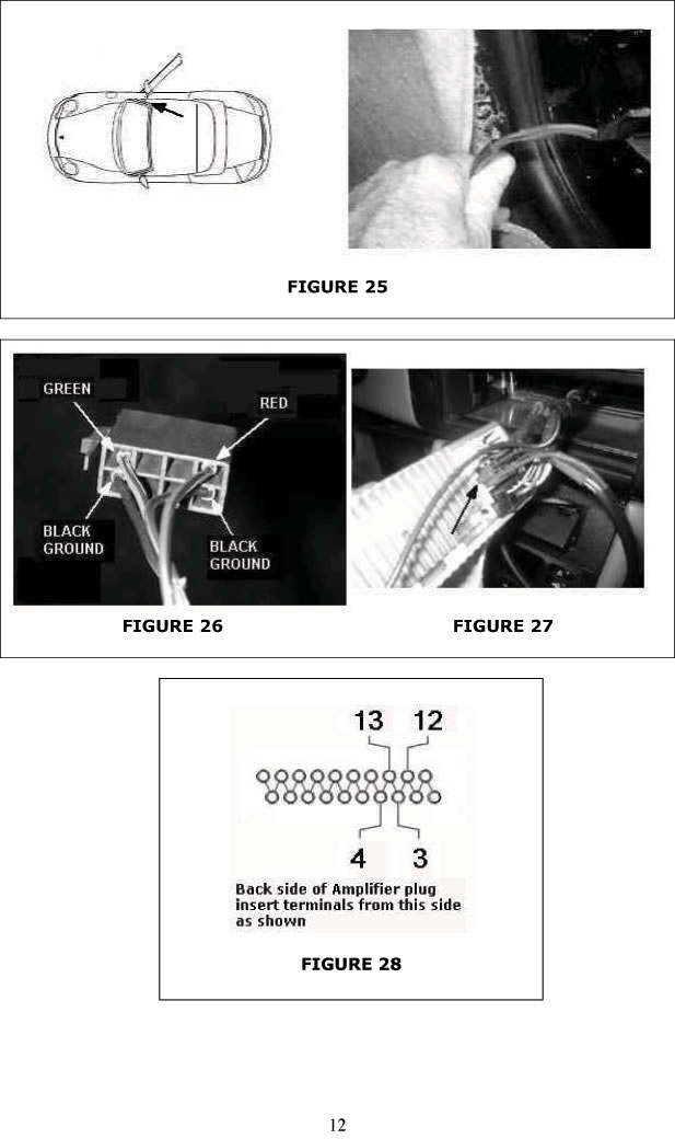

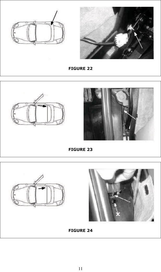

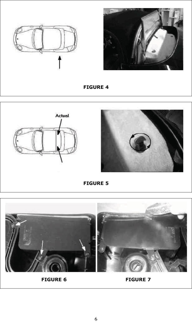

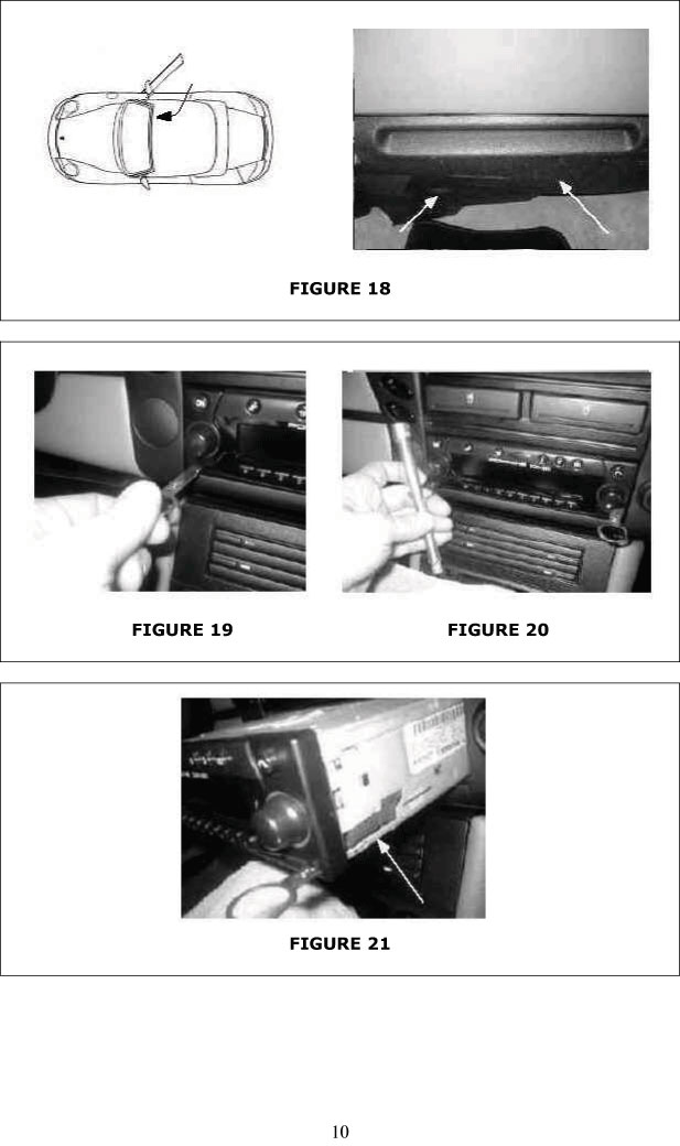

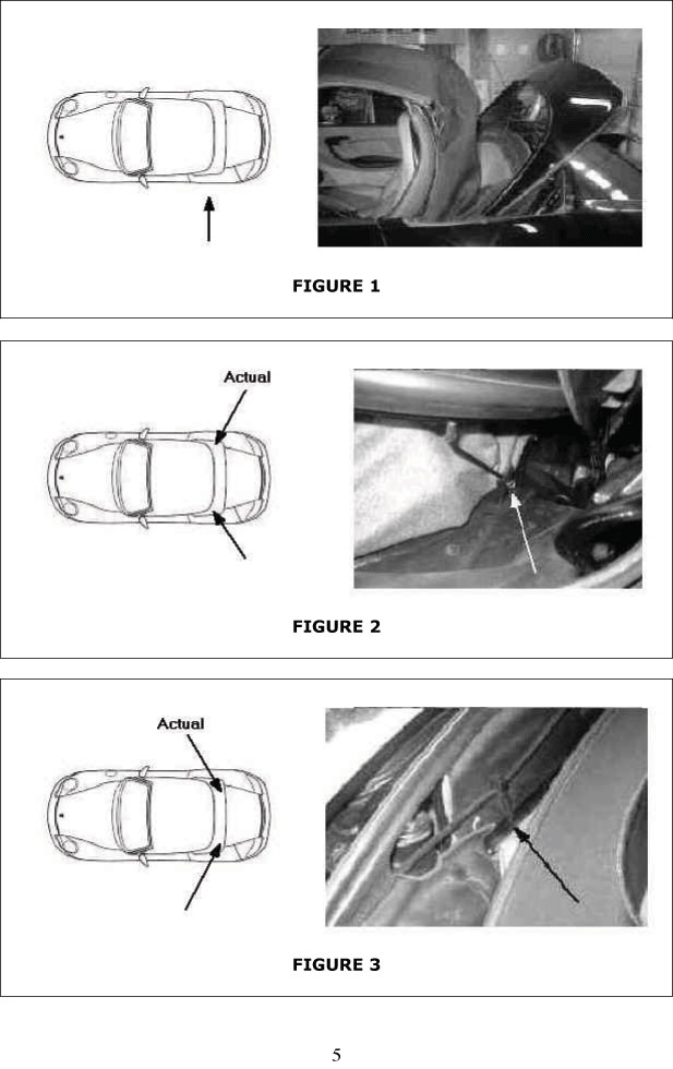

1997-2004 Porsche Boxster OEM Rear Speaker Kit

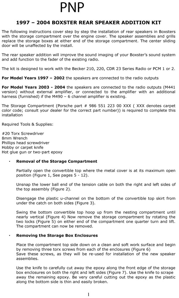

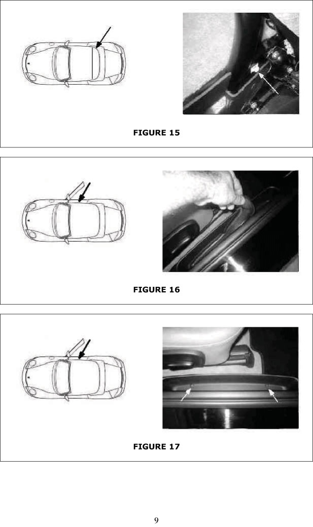

We been getting a lot of emails regarding the level of difficulty installing a Boxster rear speaker kit. We've had the resource available, but been too busy to post it for everyone. So here you have it, hope it will help those who haven't installed one yet...
Here's a link to where you can find a kit as well...

I presume you have permission from Harvey at PNP to scan and post those instructions? He's a nice guy and doubt he would have an issue w/ you doing so, but I think you should at least point people to one of his auctions for rear speaker kits too:
Harvey's Rear Speaker Kit Auction
Better yet, why not just provide a link to download the instructions in one fell swoop from his sight directly as most people have in the past:
Harvey's PNP Rear Speaker Kit Install Instructions
Porsche emailed me these instructions if anyone wants me to forward it to them. ;) Anyone looking for speaker kits on Ebay will see both, don't you think?
