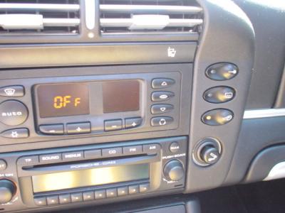

I have a 04 Boxster that i wouldlike to move the CC down to the last position (just above the shifter) and i would like to install a cubby bin where the orignal CC was. I know i need a trim piece to install the CC down low, as well as a cubby that is NOT tapered.
Can this be done (I have read wires might be too short?)
What are the EXACT peices i will need to do this DIY?
Where can i get them?
Heres a pic of waht mine looks like now..
I really want to make sure that i get the correct parts...
THANK YOU!

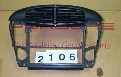

The guy in the link had a problem with a storage bin in the old a/c position, but he said it looked like the two single DIN trim had been modified to a double DIN. What that means to me is that the cross bar was removed to create a double DIN space. In the pic you see the cross bar just above the numbers.
So the question if you can put in a storage bin just above the radio, where the a/c display use to be, is still an open question. I have never seen a storage bin just above th radio. But whenever I say never someone figures out a way.
difficult to to,,,
storage bin is same size as the single DIN, on the pic above U will notice CC opening is slightly bigger.
it is hard to mount the storage bin up there, prolly have to modify the trim piece for the surrounded gap
