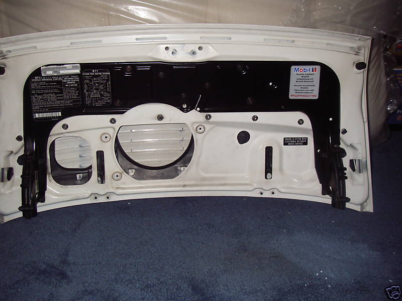

I got a 99 carrera with the GT3 body kit and wing. I got the car like this and now I got an OEM Deck lid ebay and as you can see fron the attached
picture is missing some stuff. I need to re-use from my GT3 deck the fan, hinges. My question is what I am missing? Wire harness, motor for spoiler?

based on the pic you only need the wire harnes and the locking hook (other than fan and hinges)

I don't get it. How does it raises and lowers? I got a wire harness for the fan. Do I need a different one?

the wiring harness for the OEM decklid is split. one will power the fan and wing motor, the other will power the light on the decklid.
