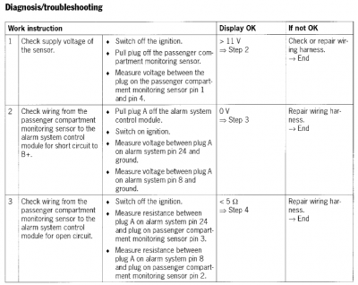

I have read most of the alarm threads but I still dont get it. I hooked the Durametric tool to my 2000 996 C2 and found 4 incidents of code 33 and 3 of code 34. I have replaced the interior sensor and I still get random alarm set offs. I do the double click and get a long flash and a single beep then the diode flashes double. A single lock gives me 1 beep and quick light flash and the diode double flashes. DO I need to look for other problems? I do have other codes 60/1time, 58/1time. Thanks

fault 33 - Passenger compartment monitoring sensor faulty
fault 34 - Passenger compartment monitoring sensor Short circuit to B+ or faulty
These two would suggest that you still have a sensor problem either a short or some other wiring problem.

Thanks I will look for shorts.

I have the same issue. Where is the sensor? Durametric can't reset these codes, can it? Mine doesn't that I can tell.
