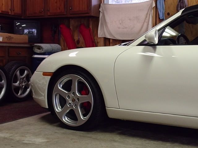

Are those RUF wheels?
They are Italian knockoffs...........19x8.5 & 19x10 with 225/35-19 frt & 265/30-19 rear..........I contacted the seller and he
accepted $1900.00 complete with tires and painted caps, shipped.....(quickly enough that you might try offering $1800.00).
Great service and quality........I would buy from them again. Here they are:
