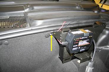

I need to get the "nutsert" that secures the amplifier bracket on my 2001 986. It is a rubber cycindar with a brass nut inside that compressed when tightened - like so many other fasteners on a Porsche. I have attached a photo to assist in identifying which part I need.

I pick one up at the local hardware store here in US in the speciality fastnr section at Lowes Hardware.
They are called well nuts. A hardware may not have metric ones. I have only seen SAE at local hardware stores.
Porsche part number is 999 500 078 00. The bolt is 900 378 179 09.
